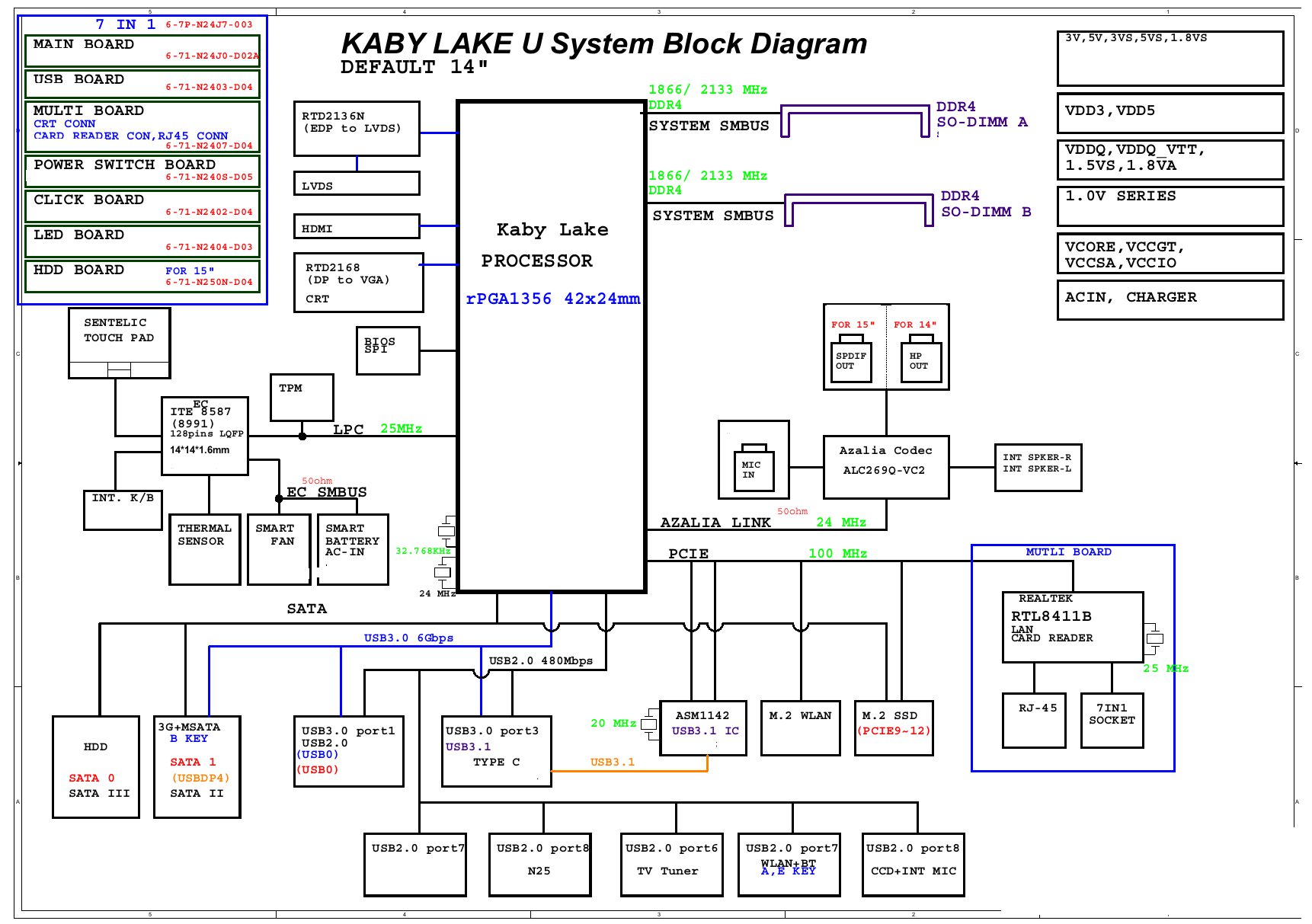

Clevo N250BU N251BU N252BU N25xBU Service Manual 2020-03-24
    Service Manual
    Platforma: KABY LAKE U
    6-71-N24J0-DB2
    6-7P-N24J7-005
