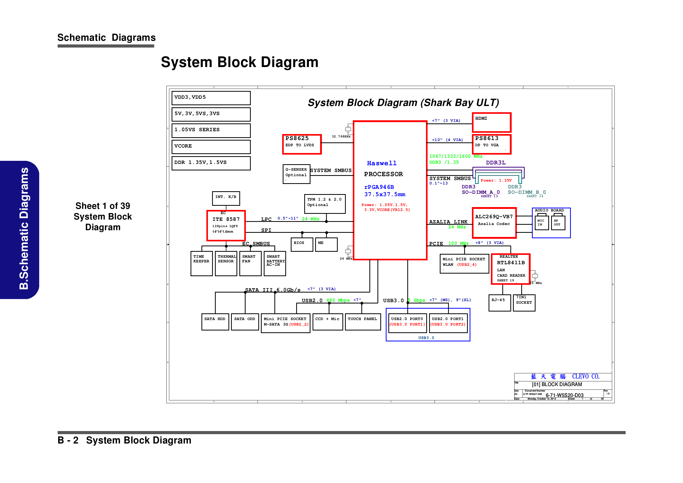

Схема + Service Manual
Clevo W940SU2 / W941SU2-T
6-71-W5S20-D02A 6-71-W5S20-D03 6-7P-W5S27-005
Rev: 1.0
Схема Clevo W940SU2 / W941SU2-T Service Manual 2019-03-25
